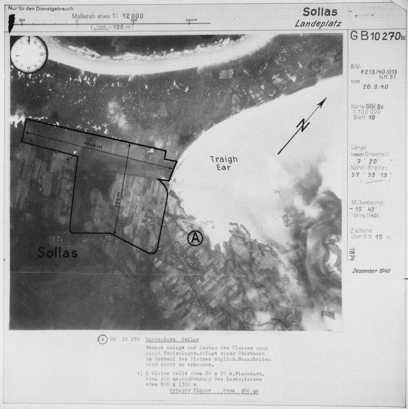

I'd a feeling that I'd heard of Sollas. There's one in the Hebrides which features a beach landing event occasionally
Noted that the spelling and location seems to vary, as do several other Scottish sites in this area. Location

I had the same feeling about Sollas, assuming I interpreted the hole punch correctly, and I think is was via a German Luftwaffe aerial photo. The same, I think, with Sandridge.

Sollas is mentioned lower down the page also photo below.

Sollas was a small pre-war landing ground on North Uist. Benbecula opened in 1944.
