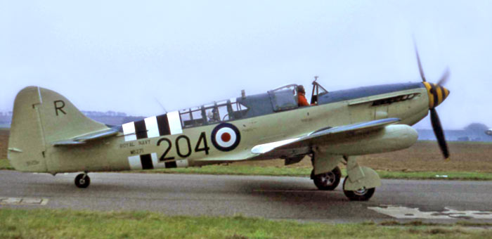

ok so what would be the best angle to show the most lights? i was considering using an actual poster in a light box with led lights popped through?
i like the 3 angle idea, but ive no idea how to fit a flasher unit to the under belly strobe light? or indeed where to buy one ?
Also has anyone got a diagram of where all the lights on a ww2 aircraft would be, ie which colors where ??

The obvious lights are the Navigation lights. One in each wingtip and one in the fuselage tail. The port wing was Red, Starboard wing Green and Tail was White. Then there were Identification lights (usually flashable to show Morse Code. One on the Fin top and on on the Fin bottom. Others on top of fuselage and underside.
Others more knowledgeable can comment on the variations but you need to know which lights your Firefly box controlled.
It is impossible to show all the lights on an aircraft from one angle which is why their were so many.Thats why I suggested a three view.

I really would try and obtain pilots notes or a lighting schematic for this, as the lighting can vary between types considerably.
I know the Firefly has the wingtip leading edge nav lights, the tail light mounted low on the rudder, and rearward facing formation lights in the wingtips.
I think the downward ID light was just aft of the flaps or hook, the upper one being between the observers glazing and the fin. The ID light would normally have different colour lenses fitted to conform with the code of the day, and controlled by one of the morse keys on your box. I think the other morse key would flash all or just the formation lights.
It wouldn't have had strobes or flashing beacons as such, they are a more modern thing, but I think all the lighting could be selected to flash intermittently, so you could have your display with either the lights steady on or intermittently flashing.
