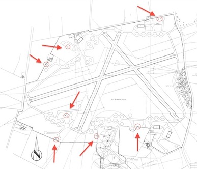

Well... RAF Balderton was a bomber and transport only facility (although I can't be sure that it wasn't envisioned to be a fighter base). It has both frying pan and loops dispersals. See the attached site plan - I've marked the dispersal huts.

Balderton started as a grass aerodrome roughly square with dispersals around the perimeter. The pans and some of the oddly placed track are the remains of this layout. Maybe earlier builds had them. If dispersal accomodation was prvided at all bases why would they build homemade sheds?
