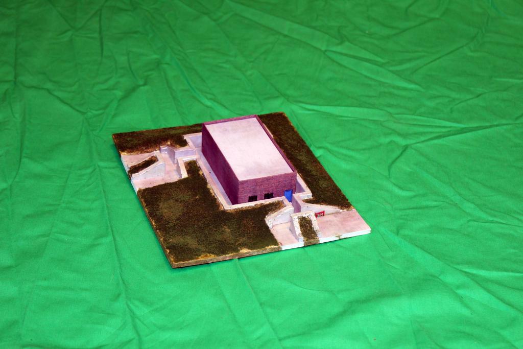

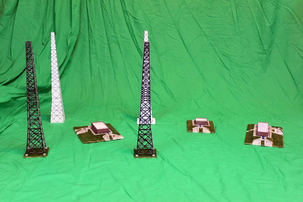

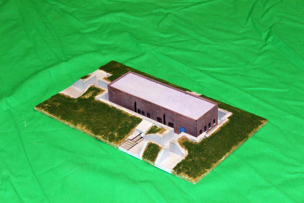

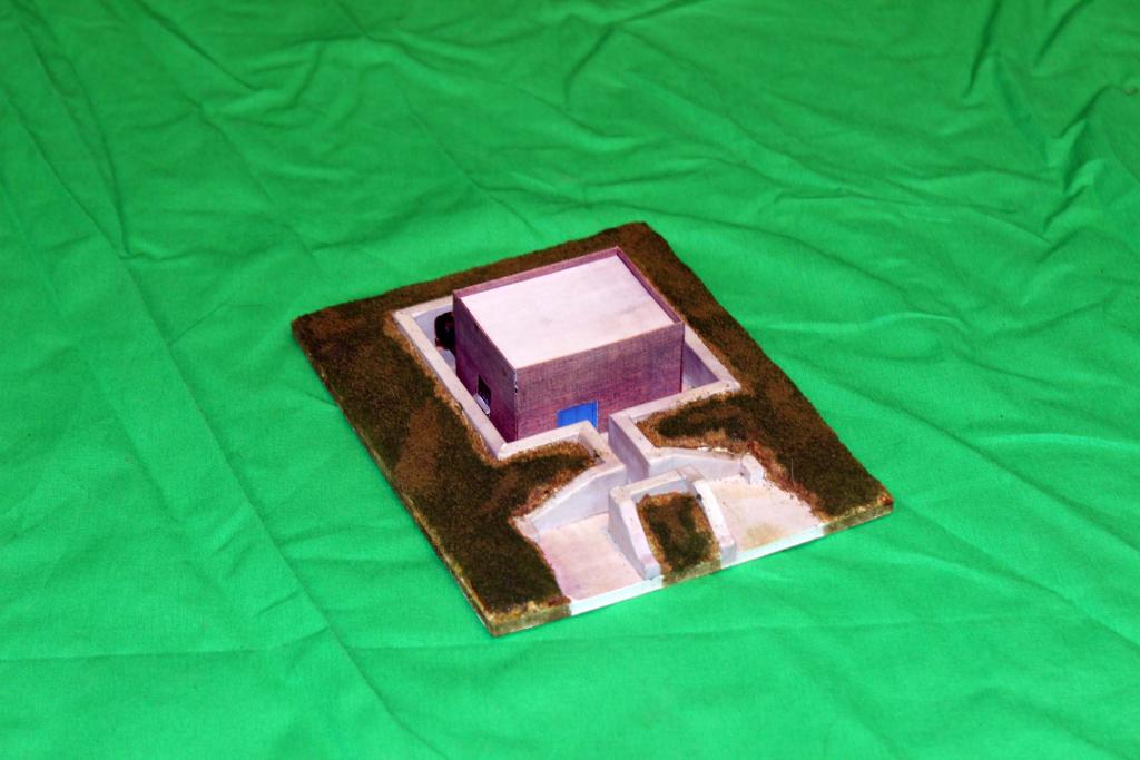

Decided to scratch build Pevensey Chain Home station in 1/144th scale circa July 1940
Used scratch build techniques similar to common N Gauge methods but with card stock, texture papers and foam board scenic bases.
Receiver Building, Standby Set House and Transmitter Building depicted are all "intermediate/final" versions blast and direct hit protected.

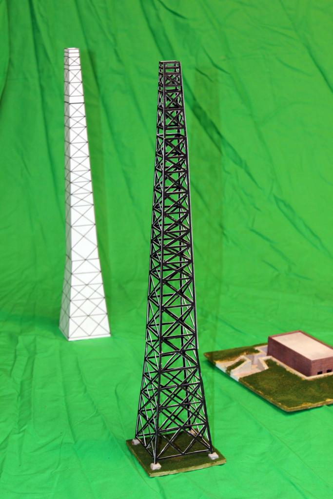

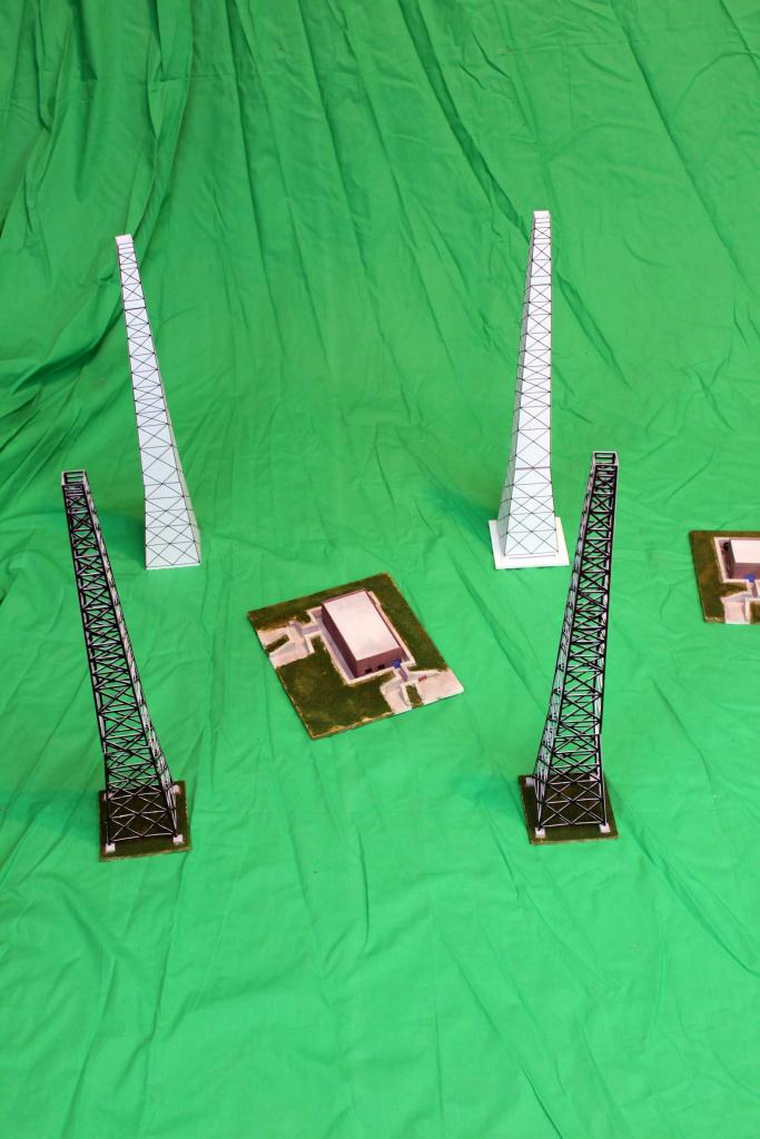

Receiver Tower is work in progress. The two wire frame dimension check models will be replaced with card versions similar to the front two. Maintenance access platforms, internal ladders and dipole aerial sets are still to be added from scratch build brass etch frets.

Space is the limiting factor.
The receiver block and the four towers will be incorporated into a 750mm square tile with the transmitter block and towers a similar but slightly longer linear tile.
Standby set house will remain stand alone but on 750mm tile to incorporate access road.
These three units plus the semidetached wardens house will complete the 1940 layout omitting the grass areas between. For exhibit they could be spaced to scale with grass mats between if room was available.
To show the development of the site into 1941 tiles for the buried reserve and associated towers will be added.
