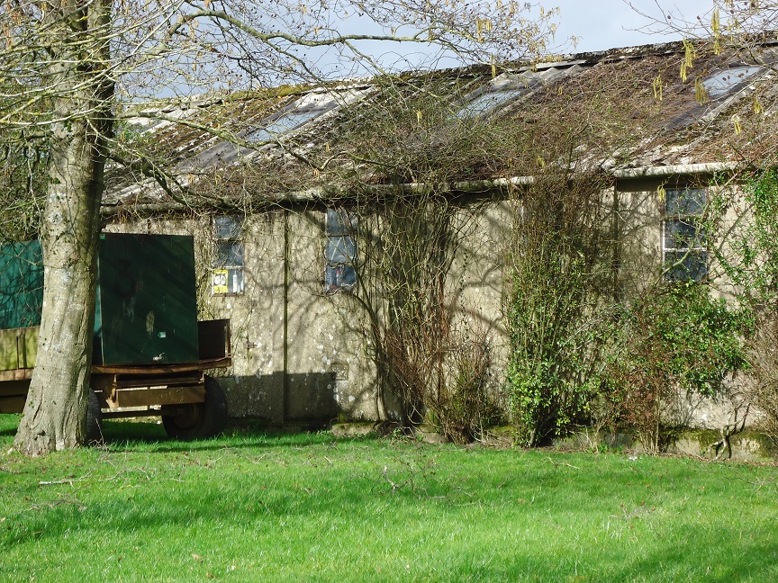

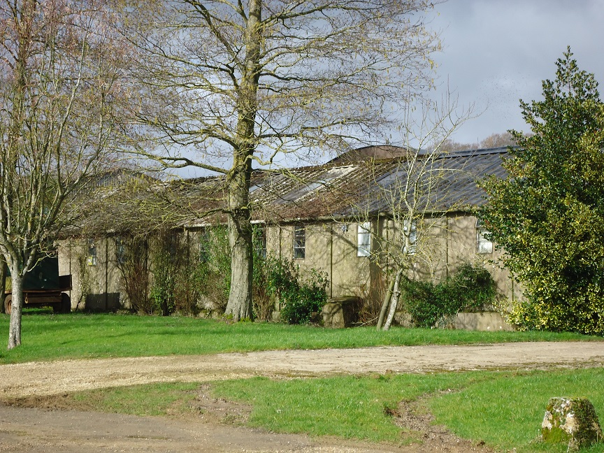

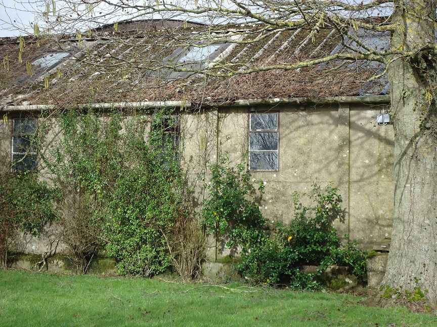

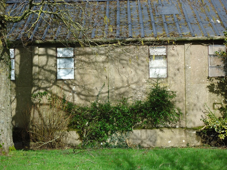

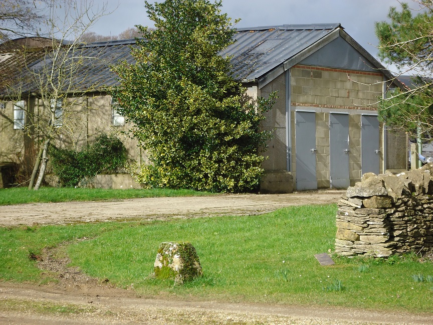

I recently saw this building in a farmyard close to the supposed site of the enigmatic Temple Guiting airfield. The structure is precast concrete with each bay made from eight slabs arranged in vertical pairs. The original roof structure was corrugated asbestos, but half of this has been replaced with sheet metal of a similar profile. Can anyone tell me the maker of this type of structure, and whether they were used for airfield accommodation or facilities, please?

Interesting post, I can tell you what its not, but what it is, is quite difficult. It is a concrete post and panel hut with a pitched roof clad with Trafford tiles, probably 24 ft span - though it looks wider, it might be a Ministry of Works standard hut, but without looking in side its difficult to say - and the windows are a bit troubling. It might be late war or immediately post-war. Not much help I know, but get some pics of the interior and then we will try again.

Personally my unscientific "gut feeling" is that this is post-war, as Paul suggests.

It looks a little like a scaled up version of my granddad's old garage that I recall from the early 1960s, it was new in the late 1940s. One of the sections had cracked and the concrete fell off revealing PSP reinforcing.
