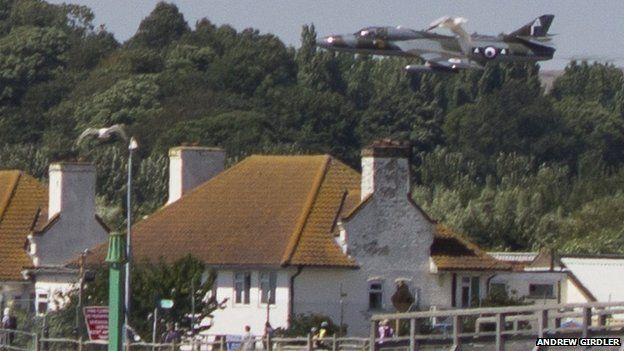

Looking at one photo of the Hunter flying level just above the trees that appeared very briefly on the web it looks to me as if the port tail plane is down which may indicate a failure of the flying tail actuator on that side, even when taking in to consideration that the aircraft is banked slightly. I'm no Hunter expert but whatever the cause it's a tragic loss and my thoughts are with the pilot's family and those of the victims and those who were injured.
Attached files [IMG]/community/163529=23975-Hunter at Shoreham Airshow 2015.jpg[/img]

Pitch control on the Hunter is by elevator however, pitch trim control is by an electrical actuator which moves the entire tailplane. The Hunter has a history of tailplane actuator problems and trim switch problems but they were all modified out.
